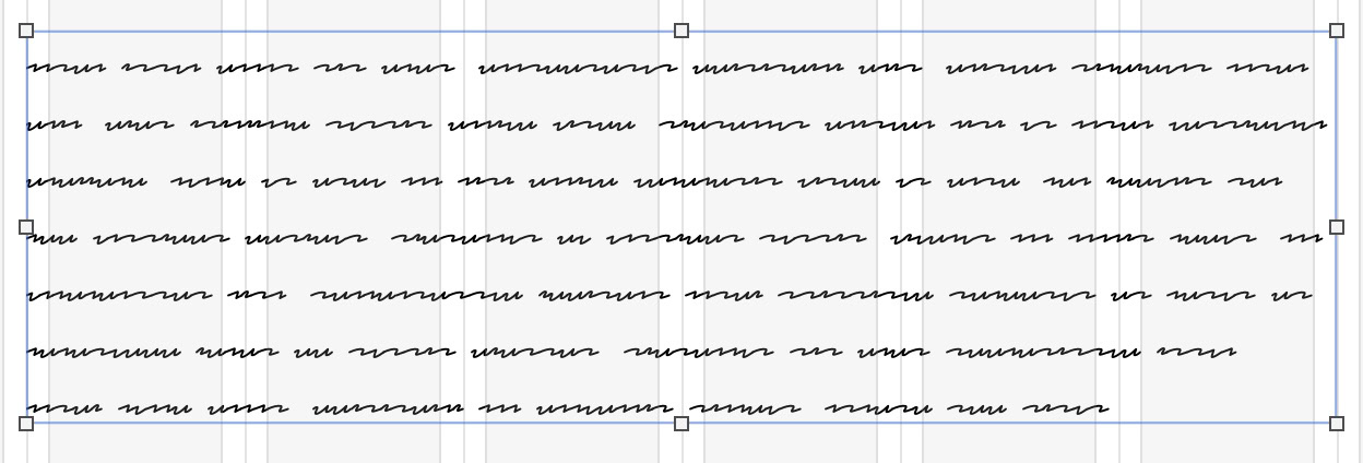

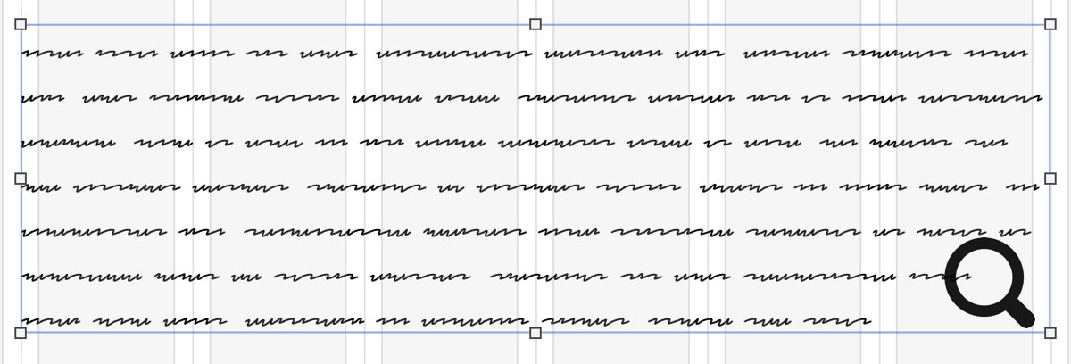

The frame itself is actually placed at the optimal size for text content on a page. On a 12 column page grid, the default text frame will span 6 columns. While you can adjust the width and height of the text frame to any size you wish, body or paragraph text is best delivered in spans of between 6, 8 columns in order to make them easy to read.

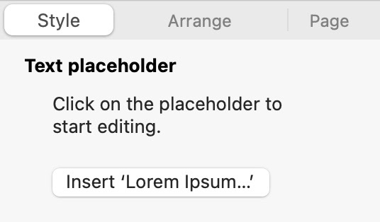

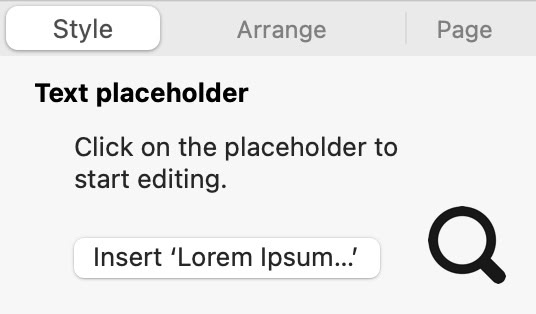

When the text frame is first placed on the canvas it contains simulated text, which is great while you are first laying out your page design. To replace the text, just click inside the frame and start typing. The simulated text will disappear and be replaced by your content. If you don’t have your text content ready, you can choose to fill the text frame with actual placeholder text that you can style to better represent how you want your text to look on the page. You do this by selecting the frame and clicking on the ‘Insert Lorem Ipsum…’ button in the style panel.
In publishing and graphic design, Lorem ipsum is a placeholder text commonly used to demonstrate the visual form of a document or a typeface without relying on meaningful content.

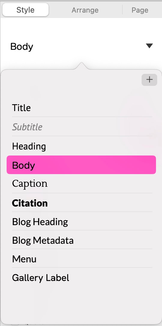

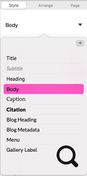

All text content, when it’s first added to a page in Sitely, will be styled as ‘Body’ Text by default. This is the most common style of text used in web pages, so it makes perfect sense to use it as a default. Sitely comes with a range of pre-made styles which can be seen under the styles section of the style panel. Text styles are actually a form of ‘productivity’ tool that helps maintain consistency, and is a common feature of most text editing applications, such as word processing software. Sitely has adopted this familiar method for styling text so you can concentrate on laying out your content in a visual way, rather than having to rely on CSS code to create the desired look of your text. In fact, styles are so important, it’s worth spending a little time exploring them in more detail.

Changing a Style

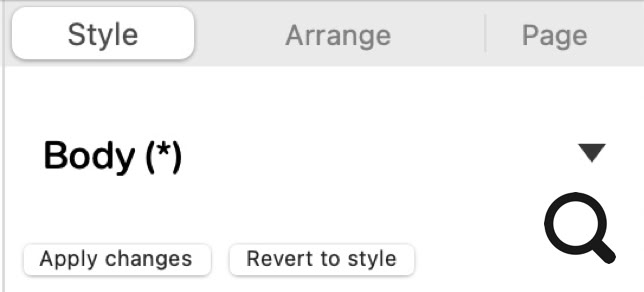

Making changes to a style couldn’t be simpler. Just select a piece of text styled with your existing style, change the formatting of that text in the style panel, and then update the style. For example, to change the style of your body text, select a text box styled as body text and make your changes on the canvas. Apply a different font, change the text size, color or any other attributes. When you make these changes you will see that an asterisk appears next to the style name in the style panel.
This is Sitely’s way of letting you know that you’ve made some changes to the style, and gives you the option of updating your style by clicking the ‘Apply changes’ button, or discarding your changes and going back to the original style by clicking the ‘Revert to style’ button. Applying the changes will instantly change all the body text elements in your pages to reflect the changes to your new style. If you ignore this option, your changes will ONLY apply to the text you were working on, everything else in your site will be unchanged.

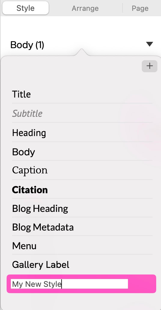

Creating a New Style

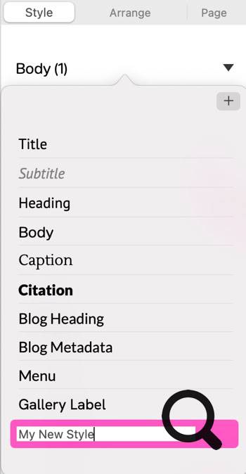

Sometimes, you may want to create a completely new style, rather than change an existing one. You can add a new style by clicking on the ‘+’ icon at the top of the style dropdown. This will create a new style at the bottom of the list that you can name in any way you like. By default, the new style will have all the attributes of your standard ‘body’ style. To set the new attributes, just create a text box and add some text. Apply your new style to the box. Next, using the style panel, make all the attribute changes you need for your new style. When you see the asterisk next to your new style name in the style panel, apply the changes. Your new style is now ready to go and can be applied anywhere in your website.

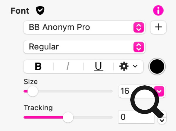

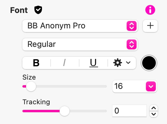

The first section in the style panel is the Font section.
Here you can select a font from the drop-down list of fonts available on your system. You can also choose from a list of font attributes, such as normal, light or bold. The list of available attributes will vary depending upon the font you choose. Some of the more common attributes are also shown as Icons, such as Bold, Italic and Underline. Some of these options may be greyed out if your chosen font doesn’t support some attributes. Next, you can select a size for your text as well as introduce some tracking. This is the space between individual letters. Some fonts have a very tight tracking, sometimes making it difficult to read, particularly at smaller sizes. The tracking option allows to add some additional space between the letters.
You may have also noticed that cogwheel icon next to the attribute icons. This is where you can set some advanced options such as capitalization, subscript and superscript, text background color or add a shadow effect to your text. Finally, you have a color well where you can select a color for your text. Clicking the color well will open Sitely’s color panel so you can select a color from your website palette.

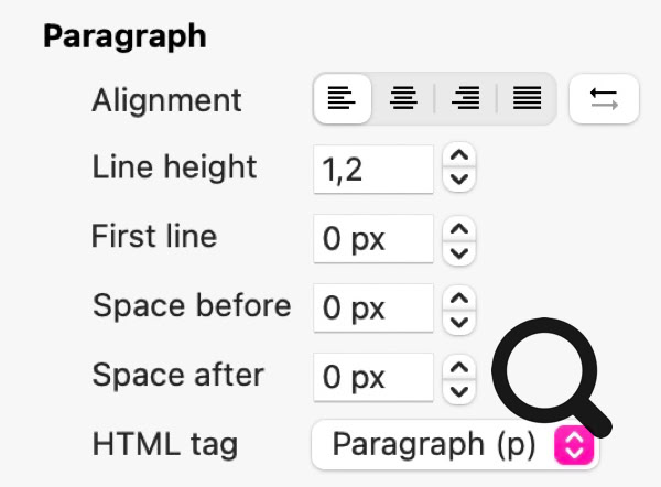

Next up is the Paragraph section.
This is where you can choose attributes that are applied to whole paragraphs. The first options are text alignment. These allow you to align text to the left, center, right or fully justified. The double arrow icon is primarily used when entering text in languages that read from right to left instead of left to right. It can also be used as a simple toggle to switch from left aligned text to right aligned.

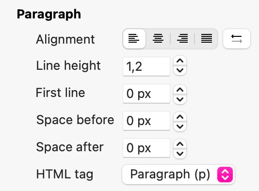

The next option is line height. This determines the space between lines of text. In web design this is best set at between 1.2 and 1.4. However, the final spacing will depend on the font and size of the text you’re creating. It’s often best to set line height visually so that it’s easy to read.
The ‘first line’ option allows you to set a first line indent to each paragraph. While this is a common feature in book publishing to help segregate paragraphs of text, it can also be used, less commonly, in website pages. This may be particularly useful if you’re setting a large amount of text where additional paragraph segregation may be important. The ‘space before’ and ‘space after’ options are for setting the line spacing before a paragraph and after a paragraph. This is the more common way of segregating paragraphs in web pages, but ultimately, it’s all a matter of personal choice.
The final option is the HTML tag. This is a sort of identifier that search engines use to determine the importance of text content on your page. While this often correlates with the visual hierarchy created by headings, sub headings and body text, it doesn’t have to be. In the world of websites, you can designate text as heading text (denoted by H1 through to H6), or it can be denoted by the letter ‘p’, which means paragraph text. In general terms, H1 is the most important element on the page in terms of search engines establishing what the page is about. Each heading level after that (H2, H6) demotes in importance. Paragraph text is the main page content as far as search engines are concerned. This is the text they will most likely index to establish relevance of your web page to search queries. As a general rule you should only have one H1 tag on a page, while you can have as many of the others as you want.

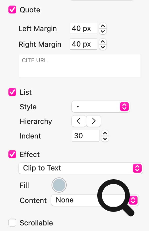

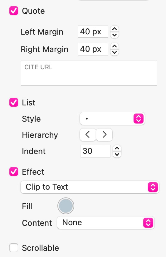

‍Quote
‍This option indents a paragraph on both the left and right. You can set the indent/margin with the options that appear when the quotes checkbox is selected.
‍List
  • This option creates a bulleted list.
  • You can select the style of the bullet, as well as adjust the hierarchy.
  • The indent option sets the amount of indent from the edge of the text frame to the bullet.
‍Effect
‍This option creates special effects on the selected text, such as filling with an image, gradient or pattern. Here is an example of the Clip to Text option in which the text has been filled with an image.
SAMPLE TEXT
SAMPLE TEXT
Scrollable
This option turns your text frame into a scrollable box so it can hold more text that can be seen on the page. When viewed in a browser, users will be able to scroll up or down to reveal the text. This text frame is an example of this feature in action. Scroll this box to reveal the additional ‘Lorem Ipsum’ text below.

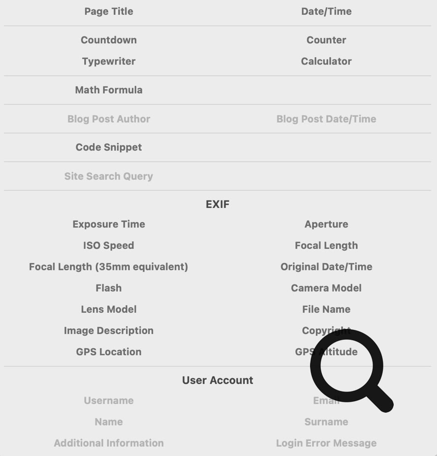

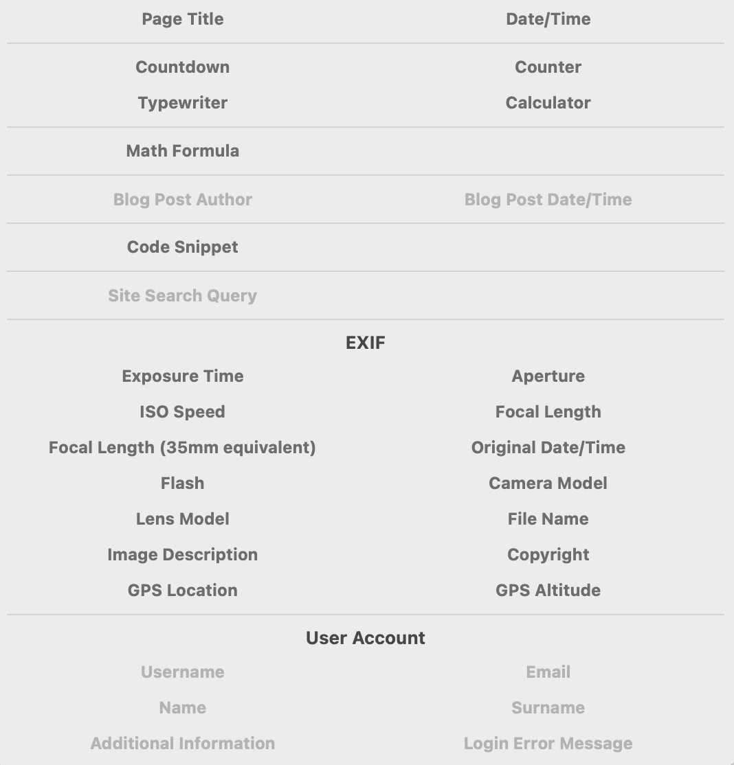

The final options are Insert ‘Smart Field…’ and ‘Insert Icon…’ The smart field option will allow you to add a field that calculates from a formula, or displays information generated within the website. The many options are shown below, but we have a whole section within our documentation that explains these options in greater detail.
Here are some examples

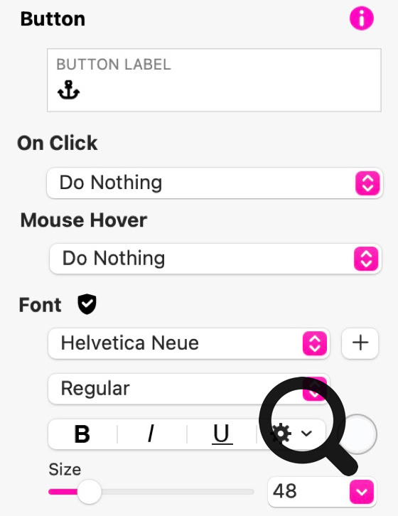

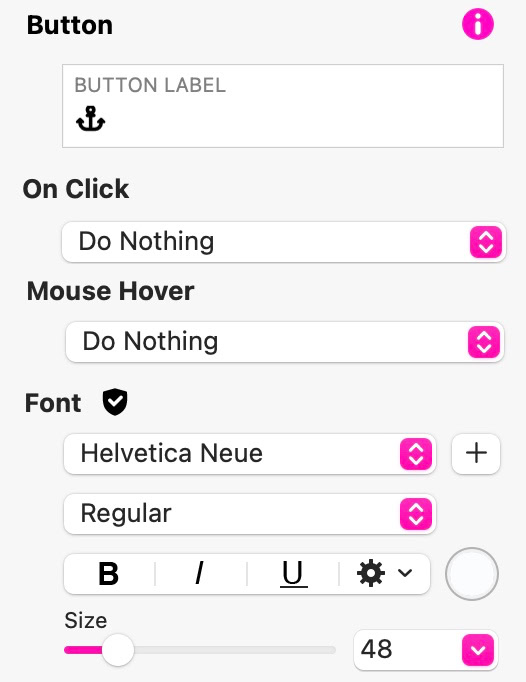

Handy Tip: If you want to create button-type icons, simply add a button to your canvas. Style it and size it however you wish. Then select the button label and use the Insert Icon option to add an Icon to the button. You can resize the icon by adjusting the button’s font size in the style inspector. This is an example of a button created this way, along with the settings for the button.
Anchor

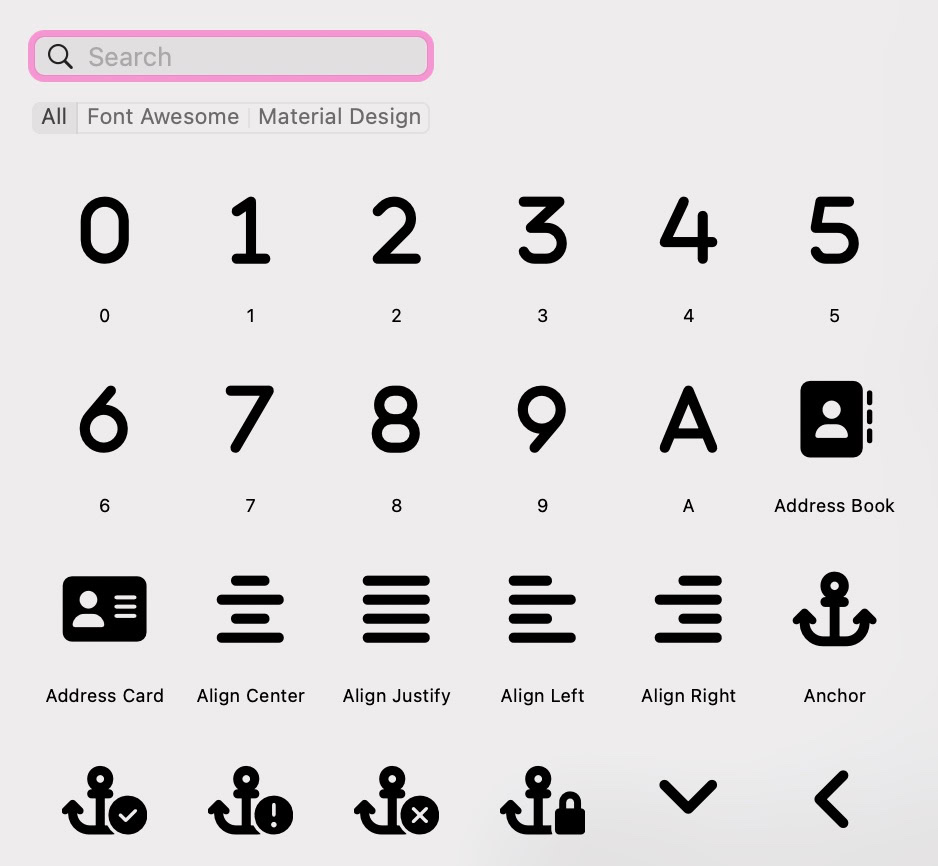

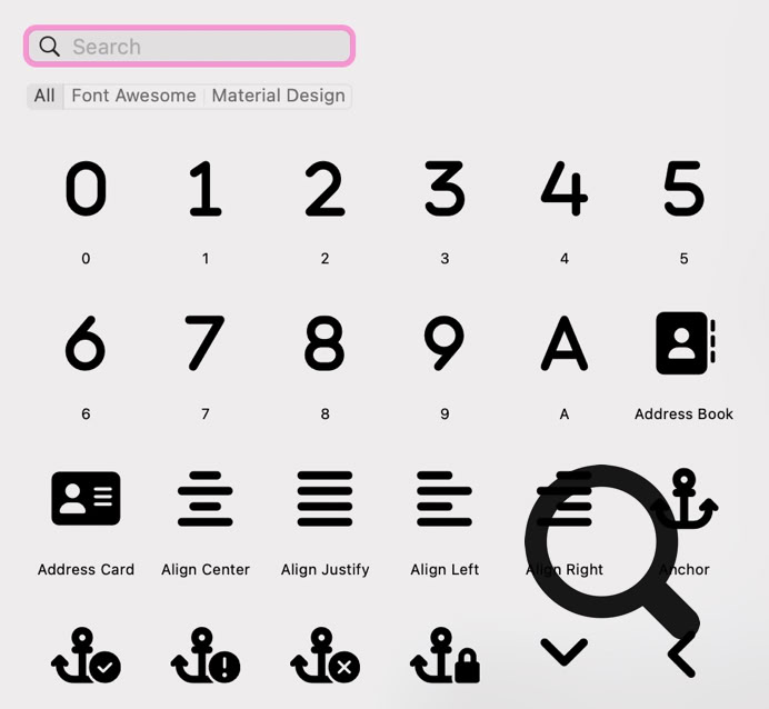

The ‘Insert Icon…’ option allows you to insert an icon into your text. Clicking this option will display a pop-up panel where you can select icons to include. Once placed in your text box, you can use other styling options to give them color and make them larger. This is how the panel looks, just click on an icon to add it into your text box.

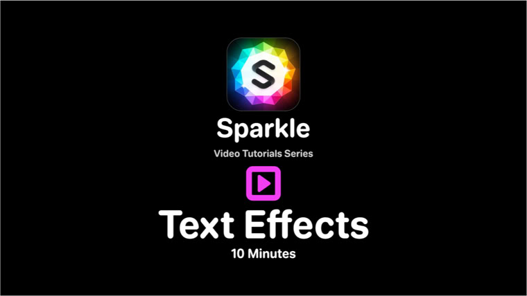

Quick Video Tutorials
Play Video
Show video
Play Video
Show video
