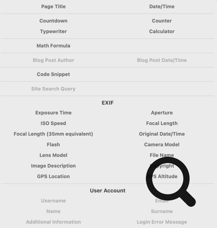

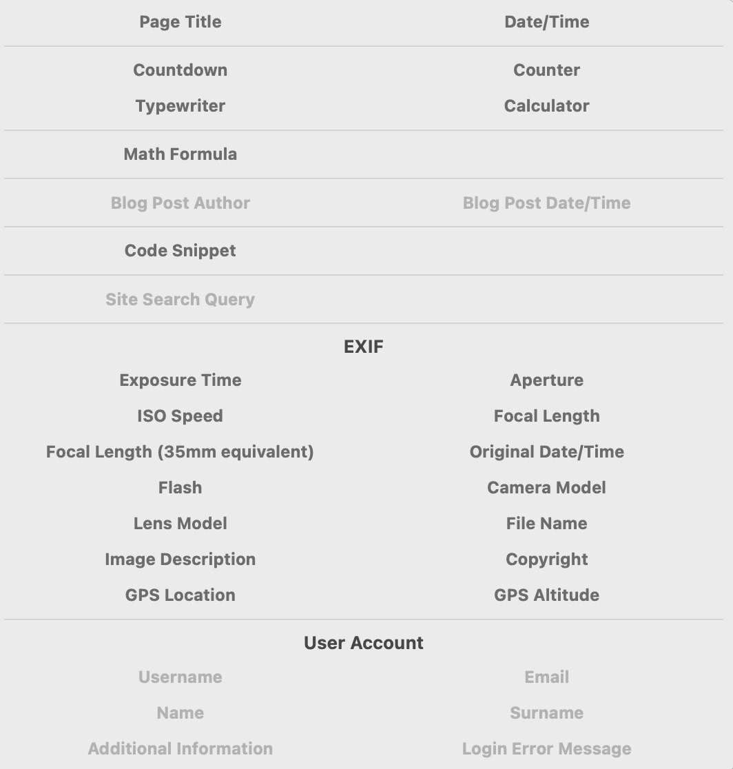

When you add a Smart Field to your text box, you are given the option of various types of fields. These are shown below.

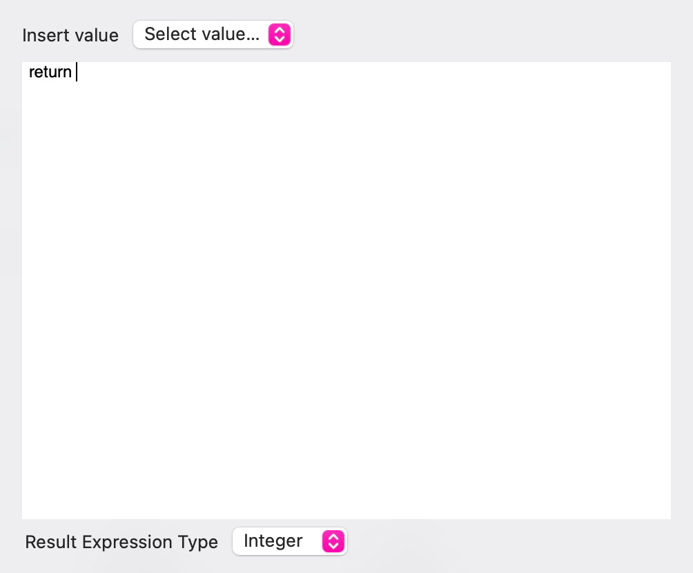

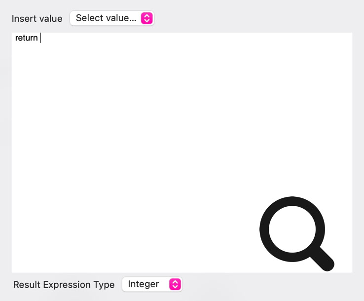

Clicking on the ‘Calculator’ bubble will open a window where you can add your calculation. Here is what it looks like.
The ‘Select value…’ dropdown will display a list of all input fields on the current page. These can be selected for inclusion in your calculation. When a field is included, it will show as a bubble containing the field name. To perform a calculation using fields, simply place a mathematical operand between the input field bubbles. Here is an example of simple addition.
‘addend1’ and ‘addend2’ are input fields on the page. These fields are normal ‘Text Input’ elements found in Sitely’s toolbox. They have both been set to ‘Require a Number’. The ‘+’ operand between them tells Sitely to add the two numbers together. Below are some examples of basic math formulas that can be set in a ‘calculator’ Smart Field.

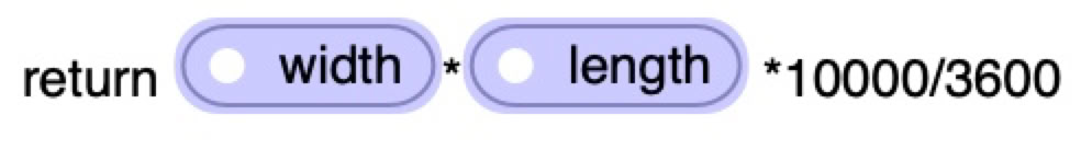

The ‘Number of Tiles’ field is a smart-field containing the following calculation.
The variables 'width' and 'length' correspond to the input fields on the page where users enter the dimensions. The constant 10,000 represents the conversion factor from square meters to square centimeters. Similarly, the constant 3,600 denotes the number of square centimeters in each tile.
The calculation for 'extra tiles' mirrors that of the 'number of tiles,' but with an additional step to incorporate a 10% safety margin. This means appending *(10/100) to the formula to ensure sufficient coverage beyond the basic requirement.

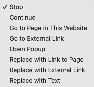

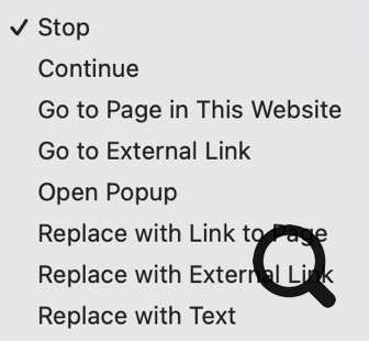

With countdown options, you can set various actions that should happen when the countdown stops. These are shown below.
