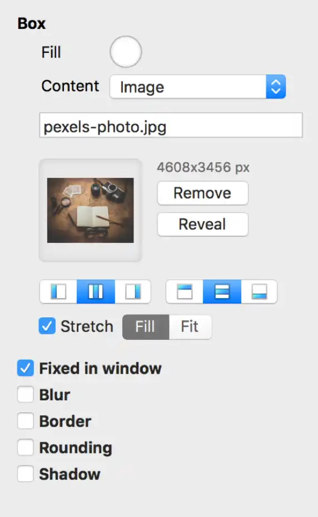

So, where do you start? Grab an image that sets the message you're going for. Now, create a box, fill it with that image, and get ready for the game-changer – click on "fixed in window." Boom! You just turned your design up to eleven. Easy, right? Here is how it works.

And here is how it’s done. Just remember you need to start with a BOX and then add your image as the box content. Once you’ve added your image, select the Fixed in window option in the style panel.
Remember, you can use a normal box, or you can use a wide box or layout block. With these wide options you would add the image as a background image, but still select the Fixed in widow option. The difference will be that the background image will span the full browser width.

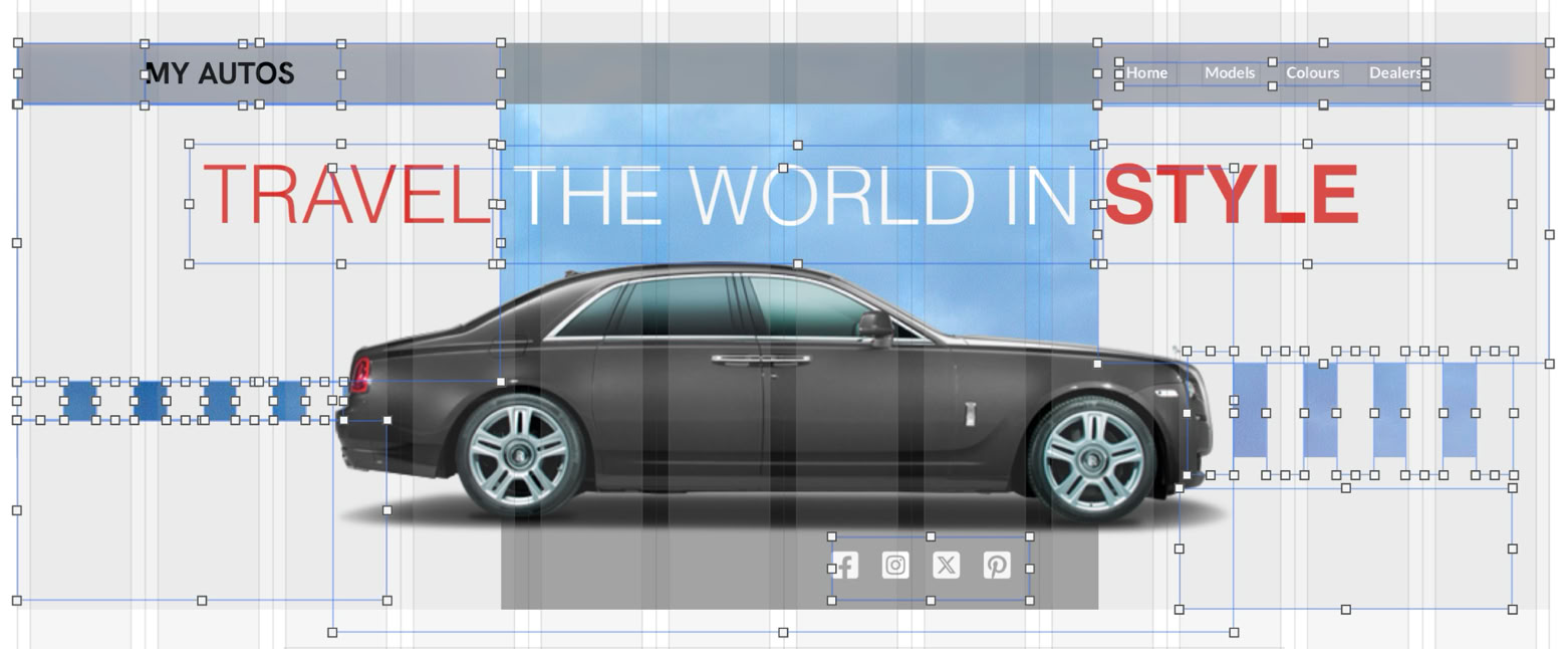

By combining different elements on top of your Fixed in Window image, you can create some visually engaging hero sections for your website, such as the example shown below.
MY AUTOS
TRAVEL
THE WORLD IN
Facebook Square Instagram Square Square X Twitter Pinterest Square
In this example, we created one large Fixed in Window image box, then overlaid it with several boxes to obscure parts of the image we didn’t want visible. Next, a navigation and social media bar, a text headline and a PNG image of the car were added to complete the hero. Very simple but also very effective. The image below shows how all the elements appear on the Sitely Canvas.
