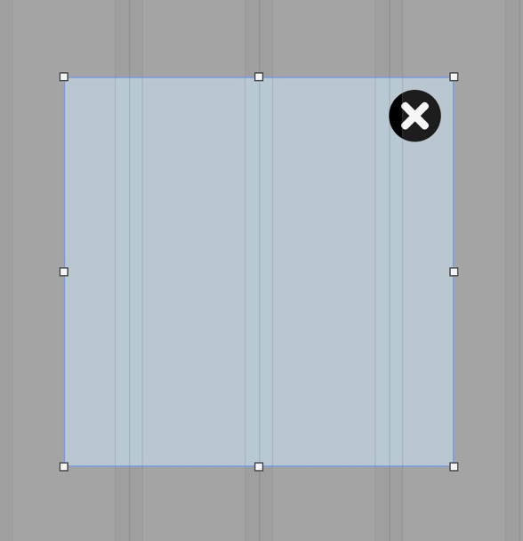

When you first add a popup, it will look like this on the canvas.
It’s a square box, centered on the canvas, with the background dimmed. It’s essentially a small, blank web page with a close button already added to the top-right corner. You can resize the box by dragging the resize handles, and it can be repositioned anywhere that’s convenient for you. The box itself will sit above any existing web page content you may have added, it’s a completely independent mini-web page and will not interfere with any existing page content.

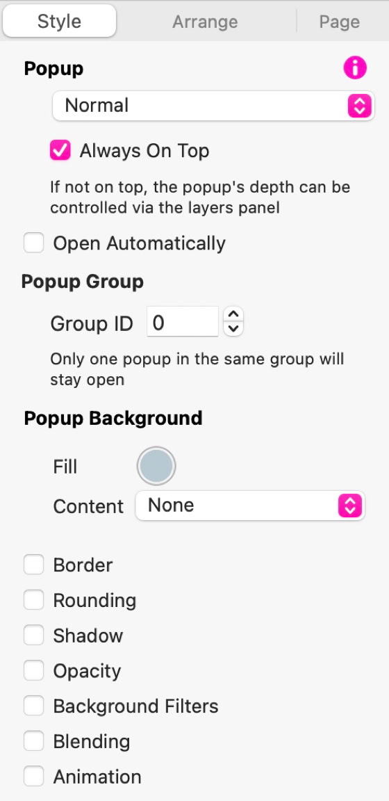

You can style the box any way you like from the style panel, including background color, border, rounding and all the other options you can apply to a normal box element. Here are the basic style elements of a popup.

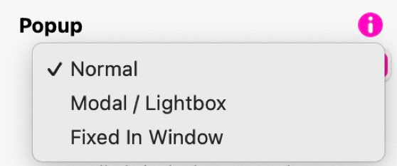

The first section allows you to decide what type of popup you want to create. The choices are:
The Modal/Lightbox option is probably the most common type of popup. It typically creates a popup centered on the page with a dimmed background over the web page. Web page scrolling is disabled when this option is used. The Fixed in Window option gives you the ability to place the popup in a specific position within the browser window and doesn’t dim the background. This type of popup will stay fixed in position while the rest of the page scrolls behind it. The Normal option will create the popup and allow you to give it a specific page position where it will remain, even when scrolling, this option won’t dim the page background. We’ll take a look at these options a little later on.
The next option, Always on Top, is simply telling Sitely that the popup will always appear above any other element on the web page.

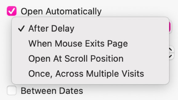

Open Automatically lets you create a popup that will appear without any user intervention. This can happen after a specific period of time, when Mouse Exits Page, open when a certain scroll position is reached or you can have it popup just once, across multiple site visits.
To see the different types, click the buttons below.
There is also an option to have the popup only appear between specific dates, great for time-promotions.

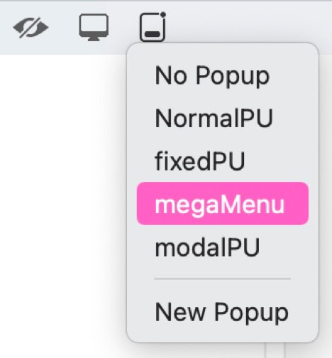

When you’re done editing the content, you can remove the popup from the canvas by clicking on the close button at the top-left of the canvas. This hides it from view so you can continue designing the rest of your webpage. If you wish to go back to editing your popup at any time, just select it from the popup icon at the top-left of the canvas.

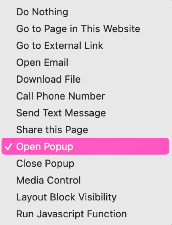

Triggering the Popup

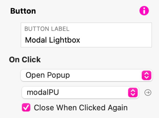

In order to make popups viewable in your website, they have to be triggered by an action. In most cases, that action will be users clicking a link of some sort, whether that be a menu, a button or text link. The on-click action will be Open Popup. When selected, you will see an additional option to select the popup you want displayed.
Already open popups will also need some sort of trigger to dismiss, or close them. Again, this can be done via a link that Closes the popup. In most cases, the same link can be used to open and close a popup. Just click the Close When Clicked Again checkbox on the opening link.
Modal / Lightbox popups can also be closed by clicking outside the modal (on the dimmed portion of the page). In most instances, the popup itself will contain a close button (included by default when you create a new popup). This can be replaced with a text link, as illustrated on the mega menu example above, or replaced with a normal button if preferred. Whatever link type you choose, the on-click action will always be Close Popup.

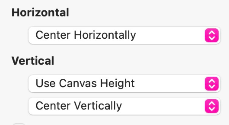

Popup Placement
The Horizontal Placement options are:
  • Use Canvas Position and Width, this will open the popup in the same position and width as you placed it on the canvas.
  • Center Horizontally, This will center the popup horizontally in the browser window.
  • Align Left and Align Right, This will align the lightbox to the left or the right of the browser window. Selecting this option allows you to set a margin to the left or right of the browser window.
The Vertical Placement options are:
  • Use Canvas Height, This will display the popup at the height it was created on the canvas.
  • Adjust to Browser Height, This will extend the popup to the full height of the browser window. Selecting this option allows you to set a top and bottom browser margin.
  • Fixed Height, This option allows you to specify an exact pixel height for the popup.
Additionally, the vertical placement option let you specify whether to Center the popup Vertically, or to have it align to the Top or Bottom of the browser window, again giving you the option of setting a top or bottom margin.
NOTE: All of the above options apply to Modal/Lightbox and Fixed in Window type popups, they are both relative to the Browser Window size. The Normal popup type doesn’t use these options because normal popups are relative to the page, not the browser. Therefore, wherever they are placed on a page, that is where they will appear.
